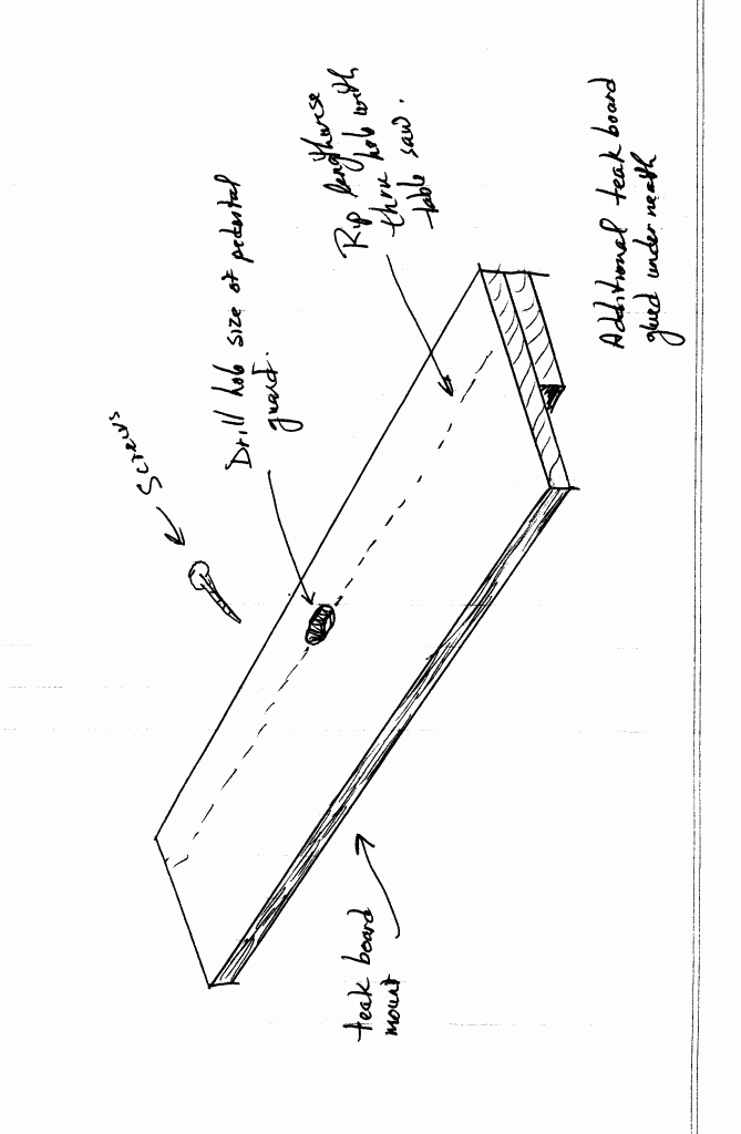

I looked for a picture of my swing mount but couldn't find one. I originally had one that was mounted around both pedestal tubes, but I sit forward of the steering station quite a bit so I found that I would constantly have to move aft to view the chart plotter. I redid it and mounted it around a single tube. The mount is just narrow enough that it swings between the pedestal guards. I can view it from any place in the cockpit just by swinging it around.
