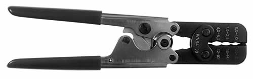

There are different crimping tools for different types of crimps. The adhesive lined heat shrink crimps use a crimping tool that looks like this;
Look closely at the jaws;
