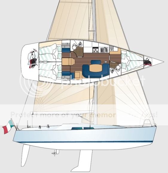

We have discussed here the shapes of modern hulls and transoms but mostly in what regards a superior view. When we look at the lateral view many surprises will appear and hulls that seemed very similar are not so similar after all. Hulls are a 3 dimensional object and it is difficult to have a complete perception of its shape.
Older sailboats had not a possibility to have what the French call a hull "tendue", meaning a hull with little rocker and for the less informed in nautical jargon, a hull where the lateral line of the boat has small angles in what regards the line that starts at the bow (at water line levell) and ends at the transom, the longitudinal profile of the boat.
They could not have that because the technology didn't allow boats light enough to do that but even so fast boats and race boats had a lot less rocker than more heavier cruising boats.

Regarding comfort on a seaway these boats are not as uncomfortable as race boats and there are some in this forum that own several of these type of boats and none is complaining. There are even one that passed to an Opium 39 coming from a theoretically much more comfortable and heavy boat, a Dehler 41cr. The program was a fast cruising boat for the family, no racing involved and I was a bit afraid that the family would find the boat a bit uncomfortable. Well, no. They all love the boat and find that it has a lot of storage and a great interior.
This approach in what regards sailing boats and hull rocker imply not an heavy boat or a beamy boat or both but it is not an exclusive of very fast performance boats, there are mass market boats with this approach and it depends much on the designer tastes in what regards a cruising boat and hull design. For example Finot and Marc Lombard generally design cruising boats with little rocker while Philippe Briand or Farr (at least for Bavaria) design boats with more rocker.

As you can see the variations regarding rocker and lateral shape of the hull are even more than in what regards the superior view of the hull, beam and shape of the transom. There are for all tastes
