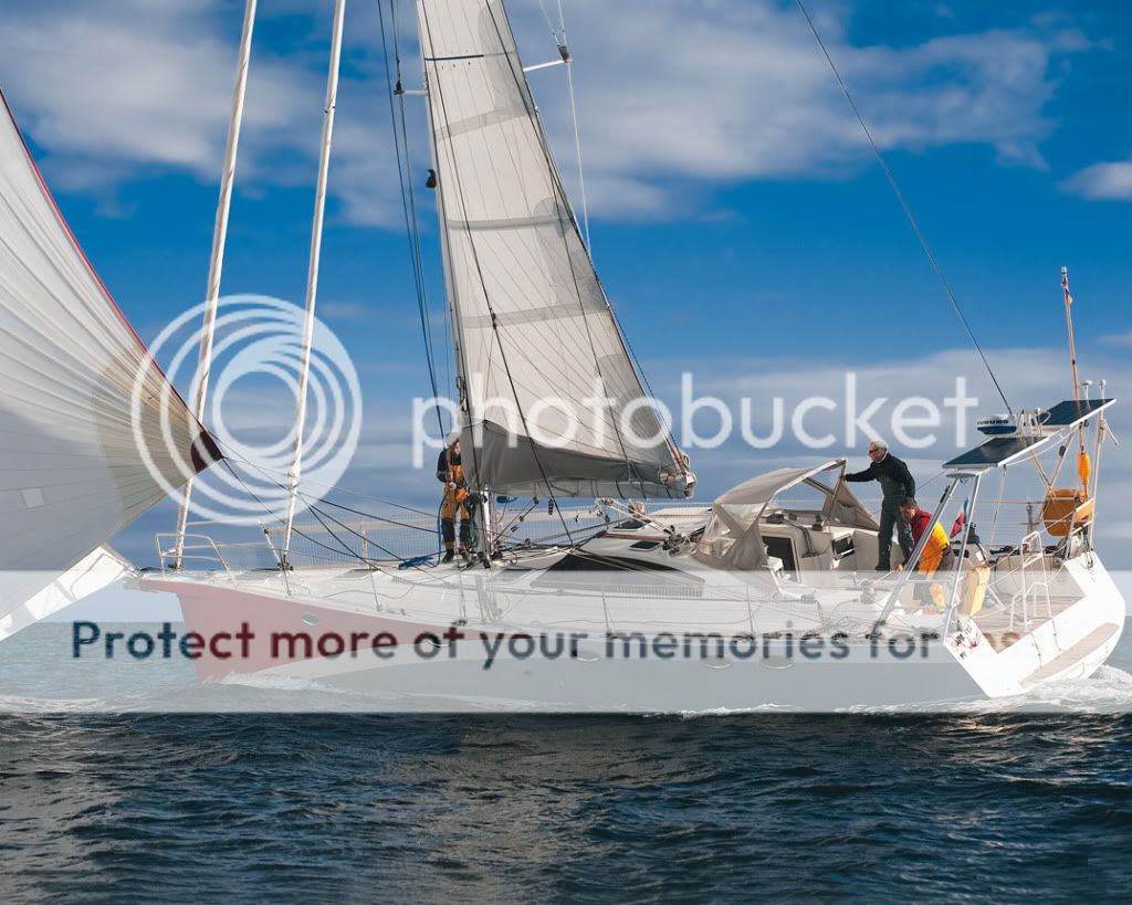

Regarding Defline, that is one of the most talented new generation French NA and puts performance very high in what regards cruising boat design I know a bit more. I know that he uses a very high end prediction speed program as a toll to help to design his boats and I know also that before using a tandem keel on a 43 foot fast performance cruiser he had done not only computer speed testing but live testing replacing the keel of a First and tested the performance before and after.
This is the Defline 43, a fast voyage boat. The boat was tested by a French magazine and they said that with 10K of wind the speeds were not far from the wind speed. Not bad for a boat with a shallow keel
[/QUOTE]
You can see the care with weight distribuition with the engine over the ballast.
