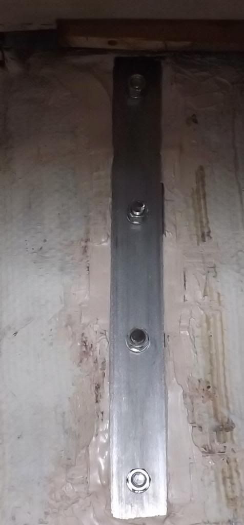

Bottom line, On that Irwin 43, of the 6 chain plates pulled (aft lower, upper, forward lower - both sides). Of the six pulled 3 had serious corrosion - see previous pictures and posts.
Here's some photo's (inside, outside) of new plates installed - basically following the same plan that Jimmy C at The Rigging Company is recommending for mine.
The Rigging Company - mod's if I'm out of line holler and I'll remove the links, what I'm seeing with 11 plus pages is a lot of folks need and want information on this.
I like dealing with Jimmy, no bull, no sugar - and never assumes he's got your job.
You've seen the outside of my 38 CC (first post) l 43 CC is pretty much the same - here you see what a bolt through would look like.
and here is the inside - note I've got LOT a lot of grinding to do
That's exactly what I recommended back in post #28. Certainly the simplest and most straightforward replacement.
