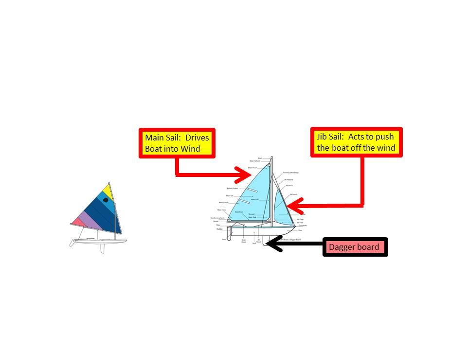

  1. BALANCING THE BOAT:
    • Davidpm: Think about the forces. Your reefed jib is at the front of your boat. It is forcing the bow down. You can counter act a little with the rudder but the main would have potentially counter acted that force and balanced the boat better. Next time try it with the main. (So balancing the boat with the main is needed.)
    • Davidpm: You will find that the more the wind the more important it is to balance the rig. That is why ocean going sailors often rig a deep third reef in the main and a storm sail set on an inner stay. Smaller sail area suitable for higher winds but still balanced.
    • Law Student: The problem was that you had no mainsail. Balance, man, balance!
  2. HAVING ENOUGH SAIL AREA TO CREATE THE DRIVE:
    • Davidpm: The main gives the drive.
    • Davidpm: The jib has no drive but helps prevent the main from rounding up the boat during gusts.

    • Stumble: Generally, sail area attached forward of the keel pulls the bow off the wind, while sail area behind the keel does the opposite.
    • Davidpm: The problem with trying to go upwind is that you need enough sail area to create drive. But with too much wind you have to shorten sail otherwise you heel too much. Then you don't have enough drive.
    • Paul in Victoria: As soon as you want to start heading upwind, you need the main there to stop the bow from blowing off. Remember that your boat basically pivots around the keel, think about where the forces from the sails are going to act, so the foresail tries to pivot the boat away from the wind, whereas the main wants to try and act like a windvane and point you into wind. Balance the two and you have a nice gentle sailing day that will feel a whole lot less crazy.
    • Stumble: Boats like a sunfish or laser only use one sail, but if you look where the mast is stepped it is far forward of the dagger board. All of the sail area in front of the board acts to push the boat off the wind, while the sail area behind it drives the boat into the wind.
    • svHyLyte: With the head sail only, and particularly reefed, the center of effort of the sail would have been too far forward to allow you to sail to weather. One can sail to weather with a head sail only but not reefed as you describe (and in the conditions you described you probably didn't need to reef the sail). As noted by others, above, next time start with the Main, only, reefed if necessary.
    • Davidpm: If you have the normal roller furling jib that gets baggy and high as you roll it up, the boat will not perform as well as it could and may even do better with no jib in some circumstances.
    • Sailormon6: I believe you were able to point on one side of the bridge and not the other because, by unrolling the jib, you greatly reduced the imbalance that Davidpm described. By raising both the jib and main, you balance the pressures ahead of, and aft of, the keel's center of lateral resistance (CLR).
      To an extent, you can do the same thing by unrolling a large, overlapping genoa. Part of the genoa extends forward of the CLR, and part of it extends aft of the CLR, and, although that doesn't achieve a perfect balance, it is adequate to enable the boat to point fairly well to windward.
      If you are going to sail on jib alone, don't roll it up deeply. If you do, you won't be able to point to windward or tack well.
      The better choice to balance the sails and to enable the boat to sail to windward efficiently in stronger winds is always to raise both the jib and mainsail, reducing the size of each in proportion to the strength of the wind.

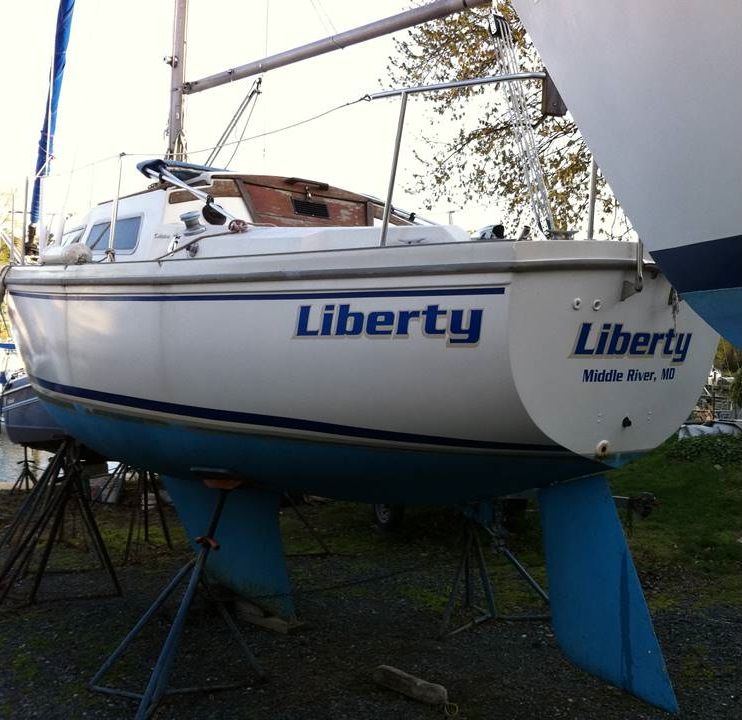

      Our boat is in the water, but from the picture of C27 below, it looks like the mast going straight down would hit the front of the fin keel. So most of the main sail is behind the center of the fin keel.
      So let me see if I can understand what you are saying in bold: If all of your sail area is behind this line, you will likely develop a lot of weather helm (ie. tendency to go into the wind) as the wind builds, and will need to use a lot of rudder to keep the bow down - which, combined with the previous comment about small mainsail area makes the boat very slow.
      QUESTION: What do you mean when you say “will need to use a lot of rudder to keep the bow down”? Do you mean that I’ll need to be fighting more with the tiller to keep the boat from pointing into the wind? As long as the boat is not pointed directly into the wind, why would fighting more with the tiller make the boat go slower?
