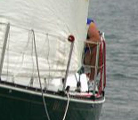

Looking at your photos it looks like you should be able to run your sheets directly from the sail, to the sheet lead block on the track and up to the winch. I found some photos of C&C 35-1's racing and that is how they are rigged (see picture below).
Also, to clarify Profin's comment, in U.S. parlance the forward block on the track, which the jib sheet is first led to is a jib sheet lead block. If there is a second block that redirects the jib sheet, that is a turning block. It does not appear that the C&C 35-1 uses turning blocks, just sheet lead blocks.
Jeff
[IMG]Photobucket[/IMG]
