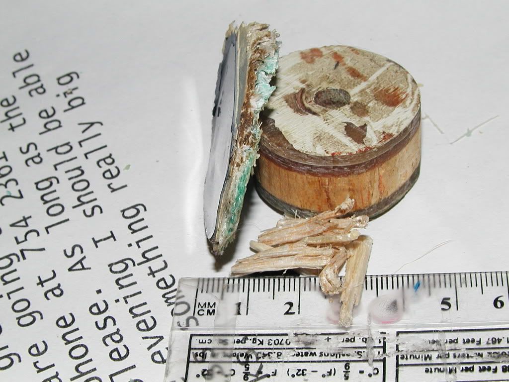

This is a J24 plug I drilled when mine was new to put in a knot meter
ALL Jboats right up to the J160 the outer skin is only about 4 mm at most

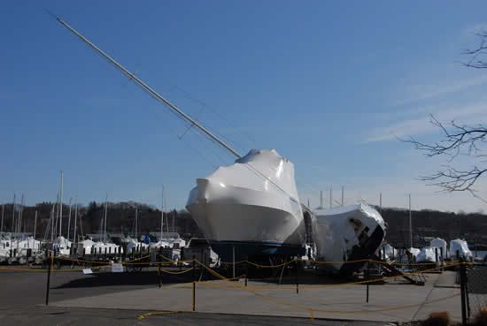

I dug that piece of skin out of the jack stands a J160 fell on in Hungtion
The warranty was always kind of a joke in that gelcoat was not covered
Plenty of J24s and J30s (the oldest boats )have gone to boat heaven due extensive core issues
