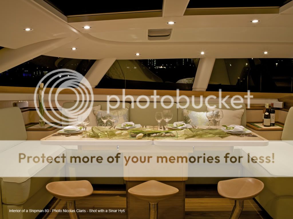

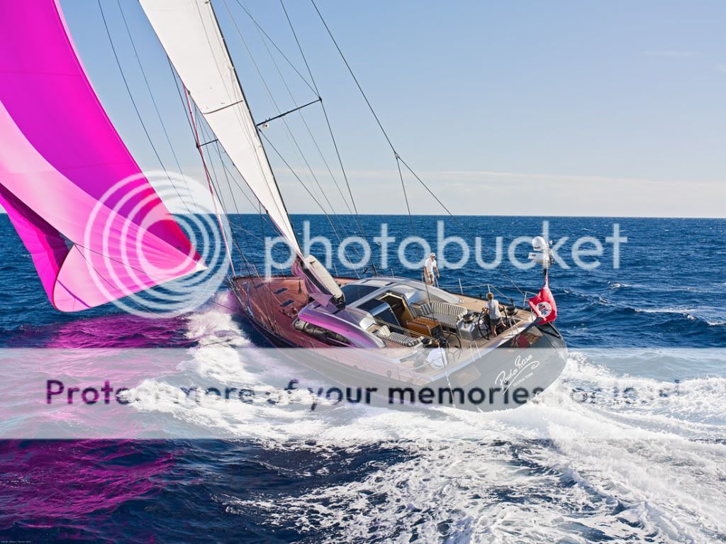

I have not yet posted about Shipman and that is strange because they are among the sailboats I like more. If I had a lot of money this would be probably on my short list because they are beautiful, fast, small draft (lifting keel), with great panoramic interiors, a lot less expensive than custom made boats and are designed to be solo sailed. That ability to be sailed solo or with a very small crew is very rare among big sailboats, and the Shipman are big. The Smallest is a 63ft.
On the year that they made that one it won the European boat of the year contest in its category and I remember that the one that was second, the Halberg Rassy 54 had an higher price (or costed about the same?). Anyhow I remember having been surprised by the "low" Shipman price, specially because this is a carbon boat and a Danish one and Danish boats are normally expensive boats (the Shipman is not built in Denmark)
Take a look at some photos of some of their boats:
The 72fter
The 80ft
80ft
Take a look at these movies about the 80ft and the 63ft:
Shipman 80 - official video - YouTube
ASW 2011 Antigua Sailing Week 2011 Shipman 63 boat speed 21kts - YouTube
