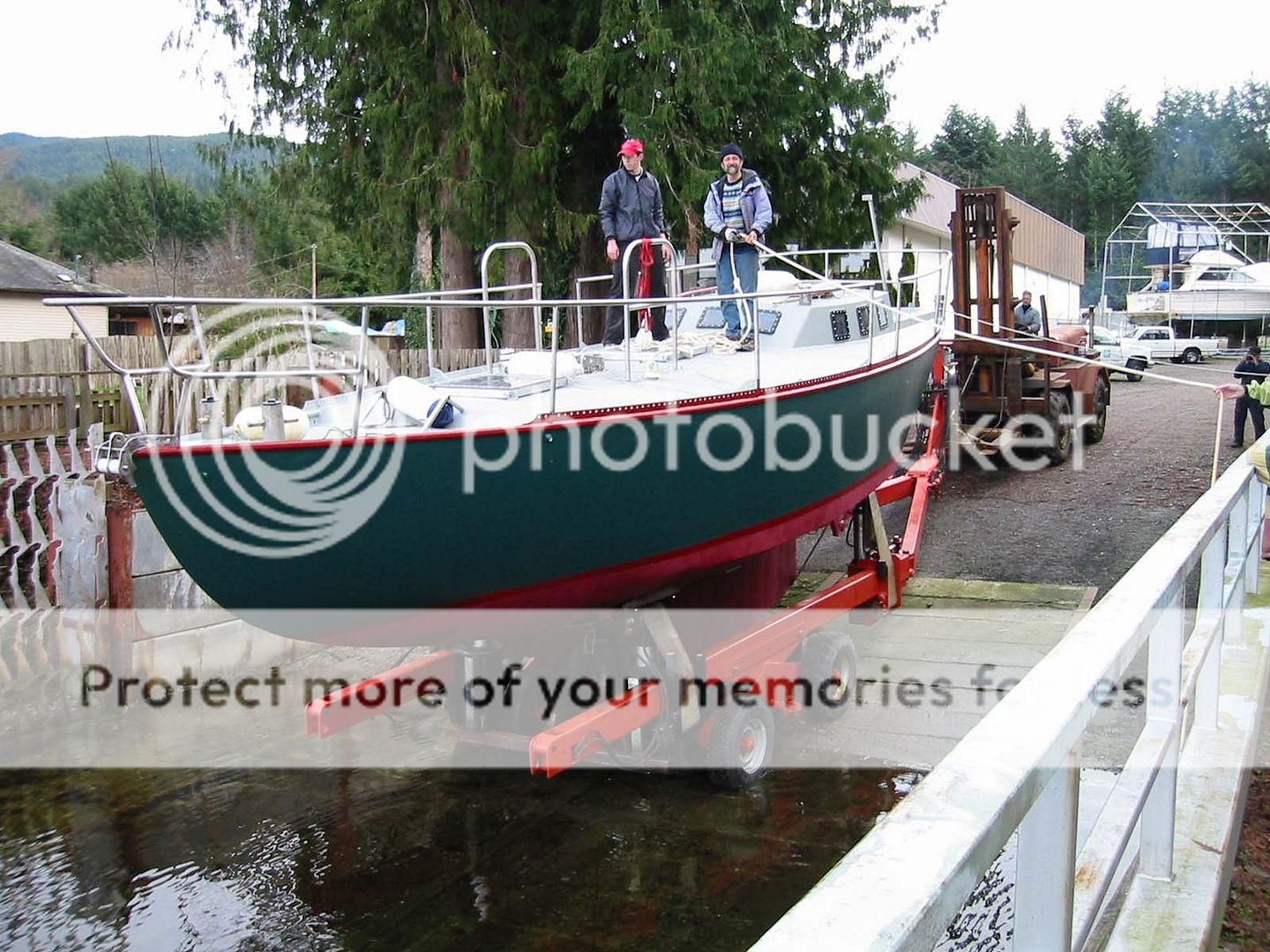

I went to the BS web site and looked at the pipe 34" life"lines". I have two major problems with them.
One is the awkward agricultural appearance.
Two is far more serious. The ISAF Offshore Special Regulations for lifelines require a gap between lifelines of no more than 15". So 28" high works as does 30" but 34" does not. You would need a third lifeline if you wanted to be in compliance. And you would need to be in compliance if you ever entered an offshore "rally" or race. These regs are extensive and they are not arbitrary. I design to them as they represent a lot of effort aimed at producing rules for a safe boat. You can find them on line under ISAF.

I had a go at the origami boat building site and find some Brent boat's that are not that ugly. I would say that even if the design is very conservative, the general aspect is nice, for a home built boat, including the interior:
Those "life rails" don't look to be 34". They look much closer to the standard height you see on most boats. Even so - without the 15" intermediate line as Bob mentioned above, very easy to fall right through that space. Sure seems like a dangerous design to me (and ISAF apparently).
