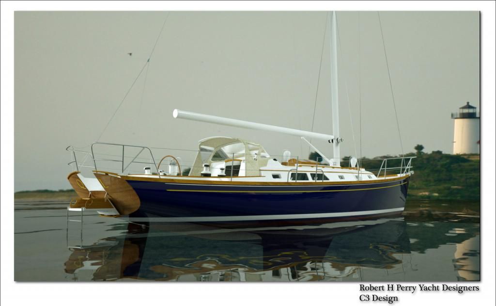

Originally Posted by Classic30 View Post
I'd be more concerned by the lack of a mainsheet. Unrestrained, that boom could make a mighty dent in your skull!
Cameron, Cameron... everything's going wireless these days, don'tchaknow???

" in a way that the naïve, production boat market demands. "
Speaking of "dense", what does that have to do with 175 degrees of positive righting moment?
Still waiting for an in depth explanation of that BS.
I don't like ugly, crude boats. When I say "beauty in a workboat" I am talking about a well designed workboat where the elements of the aesthetics are controlled. The PNW is full of great examples.
I like beautiful boats that sail very well and make their owners happy.
Compare the dainty fragile look of this boat with the obvious toughness of Silas Crosby. No decorative dead vegetation on Silas Crosby.
That dead vegetation aft platform, with its tinfoil ladder looks mighty flimsy compared to the stainless, welded schedule 40 1inch pipe I use, attached to pad eyes welded to the hull.
Jim did the 175 degrees stability curves on his computer. Ballast one side of a beach ball, with a small ballast ration, and see if you can even get it to stay inverted in water. Tanton's 30 footer has a midship section much closer to that of a beach ball than a super beamy flush decker . The high cabintop camber drastically improves it's ultimate stability, if it has the proper airtight aluminium door I use, instead of the leaky ,outdated, sliding teak contraptions on Bob's designs.
On any other point of sailing but going to windward, that dodger is totally useless to anyone in the cockpit . It only protects the back of the cabin, and looks super flimsy compared to a wheelhouse. I'd feel like a pretentious fool, huddling behind that decorative contraption in bad BC weather, when I could be in a warm, dry, heated wheelhouse.
It's typical of what arm chair experts, with little winter cruising experience, mistakenly value, while sitting in their armchairs in their warm living rooms.
I don't know of any owners of my boats who would rather cruise in something more wet, fragile and pretentious, sacrificing comfort and safety for " style over substance."
The bow roller looks like a very poor design. It is the type which wont keep the rode in when side loaded as a boat tacks around her anchor, the kind which put so many boats on the beach in the Cabo 82 disaster . I saw many like that ripped out in Puerto Vallarta, after trying to raise their anchors at Isabella, when they were stuck under a sandstone slab in a swell.
Far better to slope the leading edge of a bow roller forward, so they will keep the rode in during a side load. Far better to make the roller far stronger than the biggest line that will run over it, especially in a vertical direction, from which it will be loaded when the anchor is fouled under a rock in a swell. Rather than run it long way forward, to keep the anchor clear of the topsides, I prefer a 1/8th inch stainless wear plate on the bow , behind the roller.
I see more cruise ships doing this now, after decades of having to paint the area every time they pulled into port. ( slow learners?)

Brent.. You have your tiny utilitarian niche, and good on you.. But denigrating this heartbreakingly pretty design does you no credit whatsoever. I seriously doubt there's going to be anything 'dainty' about this boat when it's done.. And equally sure there won't be anything 'coarse' about it either.
But Smacks right.. In the end we can only laugh..
Looks much better here in San Diego where pilothouses and plastic greenhouses on sailboats are pretty non-sensical. As for dainty and fragile, I personally prefer boats that swim well over those capable of amphibious maneuvers.

I wouldn't let the "dainty" look of this design fool you. For starters it's not designed for "bad BC weather" It's a custpm boat for an East Coaster. Can't you read? This will be a very strong boat. See Brent you can't let outward appearences fool you. It's so superficial. You have zero idea of ths boat's scantlings. Yes, it will take quite a bit of upkeep to keep it looking good but my client is well heeled and keeps his current boat Bristol. I suspect he will do the same with this boat. If you are worried about the cost of upkeep I don't think this boat is for you. You could build two BS boats for the cost of the design fee on this one. A lot of time went into the transom corner chocks. It's details like this that I obsess over on custom project where I can control almost everything.
I can draw rugged boats. I'll paste a few if you like. I can do rugged with my eyes closed. But Brent you can't design beautiful if your life depended on it. This level of naval architecture combined with art is beyond your efforts. So quit being jealous. Just enjoy looking at my work and be happy that none of my clients will ever be interested in your work. I am not a threat to you. Chill. Relax. Enjoy.

It's such a great design I can't resist posting more images.
Just don't look if it bothers you Brent. I bet it bothers you a lot. HTFU.
By the way we changed the toe rail over the transom yesterday. We made it solid as you can see in the pic in the previous post. I didn't like the look of the elevated rail. I'm a nit picker when it comes to my work.
