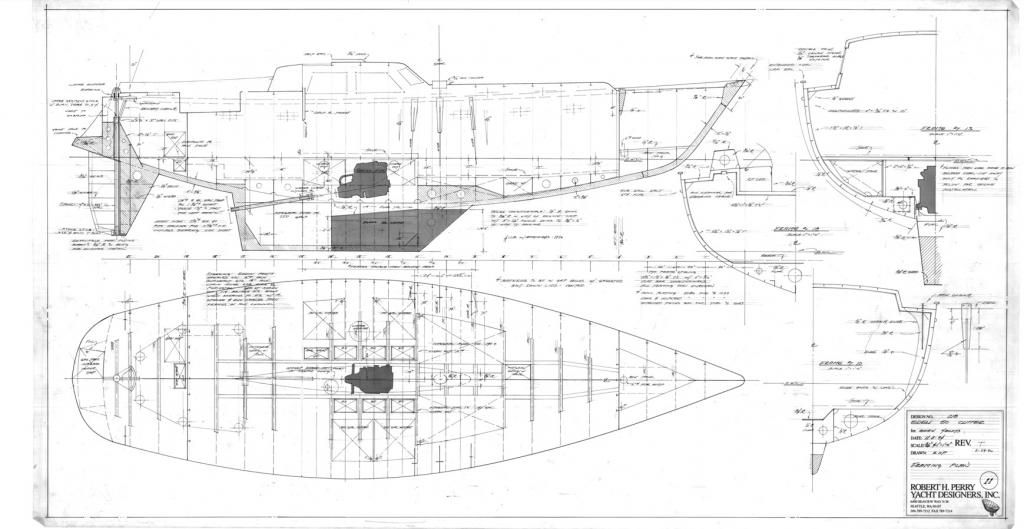

YONI was one of the last designs I drew by hand. I used pencil and ink on 4 mil mylar. I drew on both sides of the mylar to get different effects and line qualities. It was fun but changes to the design were a PITA compared to acad. There is about 30 sheets of drawings, including schematics for all systems to this design.
Nice keel rudder and skeg design.
