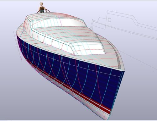

Here's today's work. I think Outbound will like this one. It's still a work in progress but it is shaping up. Check out the curved house sides.
My boat (CS 36 Merlin) is more angular than curved on the topsides. I find it aesthetically a bit harsh..
One thing I do like about it is that since the transitions between surfaces aren't large, it seems that I have more horizontal or near-horizontal surfaces to stand on..
My feet seem to understand: "Now I am on the flat, angled part transitioning to the foredeck... Adjust accordingly"
Does this make sense?
It just seems to me that I have better balance on my boat with the angular topsides..
On a similar note, my friend's 1D35 has a large, curved transition between the deck and hull.. There are no rails.
This is great for hiking.
This also a great way to lose things over the side..
David
1987 CS 36 Merlin "Kyrie"

That is exactly what we have been playing with all day. We need to strike a balance between what works and what looks best. We have been fiddling with ways to end the lower cabin trunk forward. We either have a distinct step and that gives us a squared off look to the front of the house. Or we go with a slope, a "ramp". The trouble comes when the end of the house is neither a step nor a ramp but something inbetween. We are still mucking around with it. My old Esprit had a ramp with a 14 degree slope to it. It worked perfectly. Just have to convince the client.

Bob, as I see it, being a vertical surface, a step always looks, aesthetically, like it should have something in it (generally portlights of some description) whereas a ramp, even a fairly steeply-sloped ramp, doesn't have this problem.
..so the question is, do you plan to have any windows in it - or is it solid as drawn?

The treatment of the forward end of the trunk is still up in the air. My plan was a sloped ramp with a hatch cut into the camber. Windows are always hard. You have an indea how you want them, shped then you have to fit that idea with the accomodations and bulkheads. We'll do the windows when we have all the contours established.

It's beautiful .
To paraphrase Mikey " I like it "

Thanks Out. We had to drag Phil kicking and screaming into 2014. " I don't want 3D modelling!" But in no time that turned into, "Oh,,,that's nice. Now what if we ,,,,,,,?"
I can't imagine doing any refined design work today without the benefits of 3D modelling.
It's a very powerful design tool and I happen to have working with me the very best guy, Jody Culbertson III.
