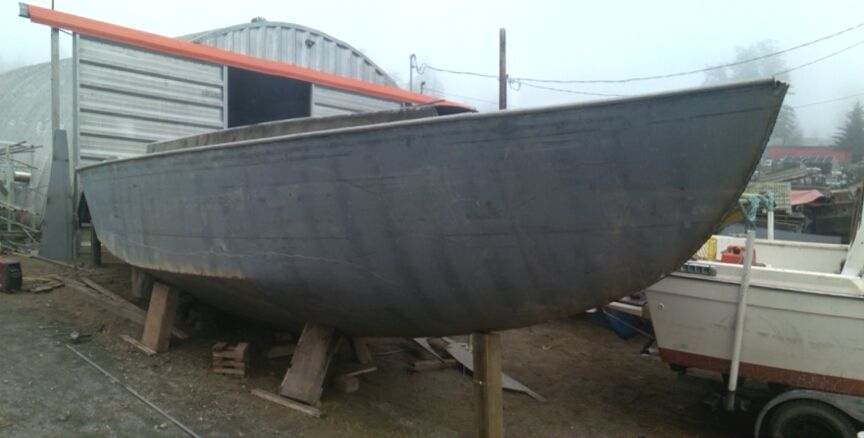

Does anyone else here Have a steel boat?
Is anyone else here activley engaged in maintaing/sailing/building a steel boat?
OR is that part of the thread irrelevant?
For me, there is no other option for material.
For one I like working with steel.
secondly, I would (and have) destroy a plastic boat amazingly fast.
The past few days I have spent Welding on the outside of my Stainless steel bulwark cap. Gonna spend today grinding it, cleaning in up and putting on the zinc primer.
I also decided that i Wanted better ventilation for welding inside the hull, So I cut the forehatch out of the boat in about 40 seconds of work. Voila! Man i love my plasma cutter. Oh yeah, and its been raining. Not much, but enough that i wouldnt be able to work on my boat if it were made of glass. Thats another thing that appeals to me.
And yes, I could probably have bought a used boat for "cheaper" But it only would have been cheaper for a few years, before it started eating more money.
Steel cost me about 9500. delivered to my house on a small island. wheeled and primed. Scrap stainless has cost me another few thousand i would guess.
the rest is time, and I have lots of that, and find great satisfaction in building my boat.

Dirty- bless you for posting. I'm curious. What designs did you research before picking your boat? Do you have the basic statistics for your boat? Have you gotten insurance for your boat? Was there any difficulties? How many hours do you think it will take to completion? What's your day job? I did schooling at the local trade high school and was amazed how easy the plasma cutter cut even 1/4" plate. Have fun.
Btw glass done right is tougher than many think. Locally a Cherubini went into the shore which was covered by huge granite blocks during Sandy. She pounded for the whole storm and was taken off days later. Went down to Delran N.J. And now good as new.

Dirty - thank you very much for posting pics and explanations of what you're doing and going through (costs, tools, etc.). This is what most of us have been hoping for. A real, current, first-hand account.
The biggest questions I have pertaining to this thread are these:
1. If you didn't have the steel-working experience and background you have, would building a steel boat still be feasible for you? In other words, could anyone do it?
2. If a person were starting from scratch (just buying the plans and going for it), how much do you think they would have to invest in tools and equipment to do this right? For example, how much is a plasma cutter, a welder, and any other tools that are critical to doing this right?
