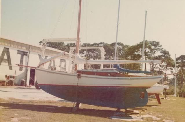

Below is a picture of 'Indian', the 1939 Stadel Cutter that my Dad and I owned for close to a decade. It shows her in profile out of the water. It pretty clearly shows what I would call a full keel and also her two blade propeller in its aperture.
[IMG]Indian out of the water, Indian Hauled out for a bottom job[/IMG]
Of all the boats I ever owned, and all the boats I ever sailed over 50 years of sailing experience, this is the only one to have caught a line in her prop. Clearing that line while working in that tight aperture was a bear. It took a bunch of dives (without tanks) since you had to turn the rudder to one side, start to unwrap the line on that side, come up for air, turn the rudder to the other side and work on that side.
