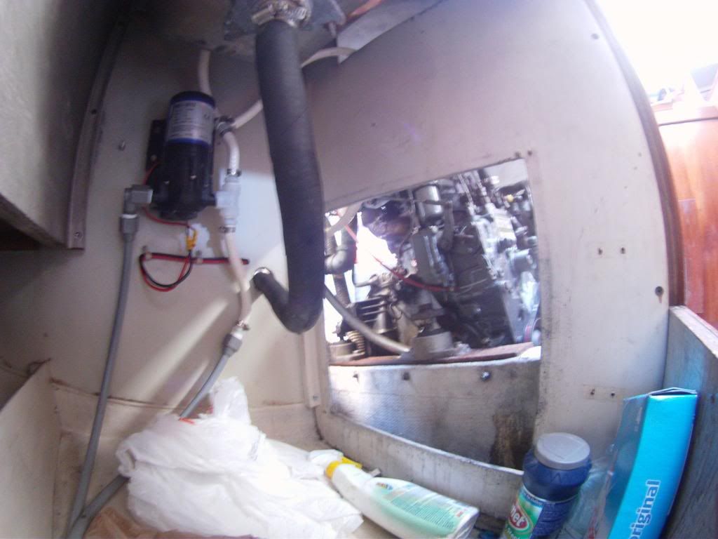

Here is a few shots of the engine coming out Yesterday.
