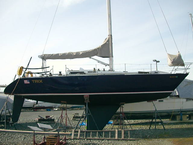

I think this just shows hard it is to compare and predict prop performance (especially more subtle things like prop-walk and vibrations) between boats. I wish there was a cheaper way to test them on an individual boat.
Edit: I think this is the same as your old 40, a similar (just larger) underwater configuration to my Pearson:
Ha! looks familiar, allright!

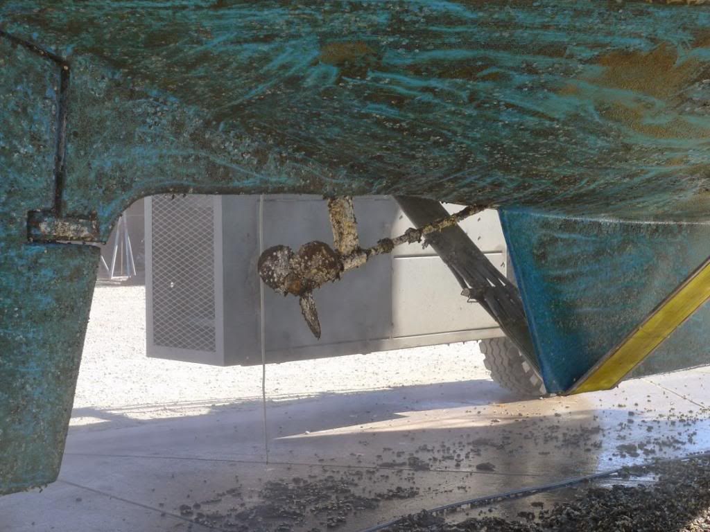

My three blade is in my opinion smooth and produces minimal prop walk.
That changes after a couple of months in the water.
Whoa!!! Chuck--You need to hire a diver!!! (Or dive the boat monthly yourself!) With that bottom/running gear, that boat must be slower than a herd of turtles after a few months.
You might also have some "PropSpeed" applied to your running gear during the next haul-out, backed up, monthly, with a hand applied film of a product known as "PropGlop". You might also think about a different brand of bottom paint. We're using Trinidad SR and we virtually never develop barnacles on the hull like that, even with 3 years between haul-outs in the waters of southwest Florida.
I didn't want to say anything.
I have had conversations with Chesapeake Bay hull cleaners in the past, and they indicate that this level of fouling is common there, regardless of paint condition. Apparently, using a scraper there is how you get a hull clean (and you can certainly tell by the pic how "clean" that is.)
My question to Chuck is; how old is the paint in that pic and how much time had elapsed since the bottom was last cleaned?
