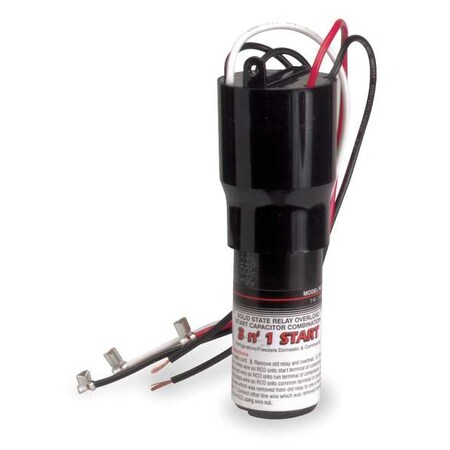

cap is shot. it's swelled at the top. get one see if that works. If when you turn it on and it hums.. then clicks, try one of these It goes on S & R
Good luck!
