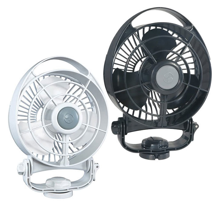

You might want to look into the small portable ac units that fit over the hatch or companionway. Then tend to be bulky however and you need to stow it somewhere when not in use. 12V oscillating fans work quite well also.

It really depends on whether you're going to be at a dock with shorepower or anchored out. Anchored out, the windscoops and small 12VDC fans are probably the way to go. If dockside, then an A/C unit might be the way to go. However, the fans and windscoop are probably less expensive overall and far more useful, since they can be used at the dock as well as at anchor. You'd be surprised at how much difference small 12 VDC fans can make.

There is a difference in fans too. I just replaced my Guest fans with the Hella Turbo's - more airflow and much (much!) quieter.

Labatt is right. I have Guests and they are noisy.

I have both Hella Turbos and Caframo Bora fans... both are excellent, however, the Hellas are better for bulkhead or overhead mounted fans, since they pivot at the center, the Boras pivot at the base.
