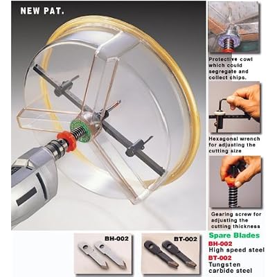

Great! Thanks. Nice reference manterials. Do you know if they make an 8" diameter hole-saw?....or is that a jig-saw operation only?

Pub...here ya go for big holes...not cheap but lots of other uses!
http://www.amazon.com/gp/product/B00...BR4XRSA8CVAPMH
