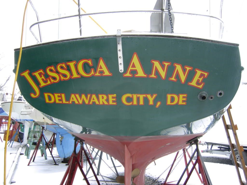

Like Halekai said, a heat gun works very well. I stripped my entire transom in about 30 minutes with a heat gun. If you do it just right the adhesive comes up with the decal and you will only have little traces here and there to clean up. I went from this:
to this:
with a heat gun, and some 3M super duty compound. Of course my 25 year old green hull will show more discoloration that a newer white boat.
