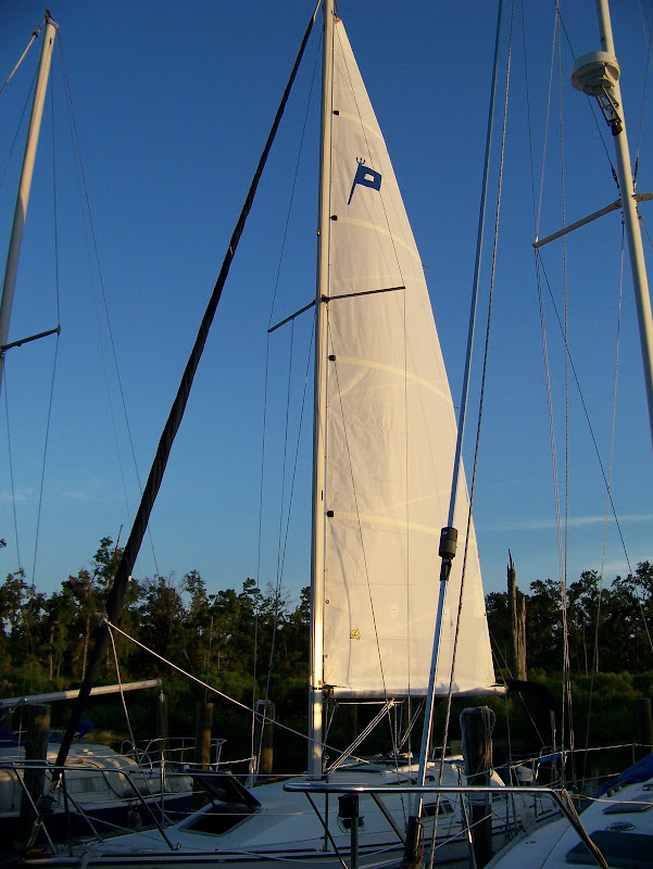

Looking for advice on best way to rig reefing points. I added a new full-batten, loose foot mainsail this past summer to my Pearson 27. The previous (original) sail was a closed foot, with one reefing point about 48" up from the foot, set up for single line reefing from the cockpit. It worked, but there was a lot of friction. The other problem with this system is that to release the outhaul, one had to go to the mast anyway.
Original system - I have first reef point rigged like this for now:
Due to a misunderstanding the reef point was put in at about 32" instead of 48", so I just had them add another point at around 64". I've temporarily rigged the first point with the single line system, but would like recommendations on how best to rig both points. I primarily single-hand, daysailing and overnighting. After searching through the forum on this topic, I'm thinking reef hooks at the tack, and two lines - one for each reef point - at the clew; the line would run from the boom up to the cringle, down to a cheek block on the boom, then forward to a cleat near the tack so I could reef either point at the mast.
New sail; first reef point visible, second reef point was added later above first batten:

I could probably make a two-line work if I upped my Garhauer clutch assembly from three to four - will have to check if it is the same footprint because it is actually attached to a plate embedded in the cabin top (as opposed to through-bolted). I have an extra sheave on the footblock, and two mastblocks in place now for reefing so could probably rig one reef point aft with the two line system. As you can see by photo below, however, I don't have a lot of extra space to play with to add footblocks and clutches, so rigging both reef points with two-line system to the cockpit would be too much. Then of course there's still the issue with the outhaul, which is not run to the cockpit.
You're right about the single-line, it works but not very efficiently - whether reefing or shaking out. I could rig something like this fairly easily: http://www.stewartfam.net/arlyn/myreefing.jpg

The only way I see to lead all reefing lines to the back is if each reef is on a single line (total of two lines), due to the limited clutch and line space. I really can't route any lines to port because of the hatch. In this case, Catamount's setup would probably be the way to go.
But I think in the end I will probably go with the two-line system for each reef, set at the mast.
