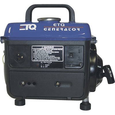

I'd get one of these:
Cheap Portable Generator | Buy Portable Generator | Best Portable Generator | Discount Briggs & Stratton Portable Generator - Eastern Tools & Equipment 1,200 Watt 2 HP 2-Cycle Gas Powered Portable Generator (Non-CARB Compliant) #TG1200
At $150 bucks...you will always have power and the ability to charge your battery.

Cam; is that genny you show reliable? I don't want to waste 150bucks on a madeinchina POS aka use me twice and I'll die
I found a Honda gen unit, really small and portable. About 600$. It has about 80dB noise level and 1 gallon gas tank... However, my concern is where to keep it in the boat? I don't think they are really mean to be used in marine environments where it's moist all times if not wet...
