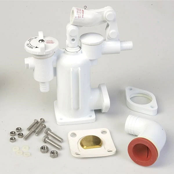

For about $150 you can buy a "Pump Assembly Kit" and save your free time for sailing.
For the PHII
So for about $100 more than the rebuild kit you get everything you need, and its all brand new and ready to go in.

Pamlico- the pic looks just like the pump on my head. Do the PHI's look the same or are they distinctly different? (where'd ya get the pic) Thanks folks!
Old 07-22-2008
Pamlicotraveler's Avatar
Location: Creedmoor NC
Posts: 534
Pamlicotraveler is on a distinguished road
NC-They are probably different. This is for the PHII
This is from Defender
