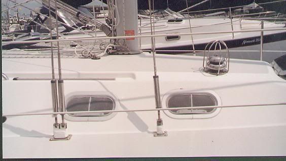

Originally Posted by christyleigh View Post
Here's a picture of the Dickensen propane chimney exit on my last boat. I used 3 overlapping Boom Bails to keep the lines from snagging and in the 4 years after installation I never had a line snag.
That's clever. I like it.
