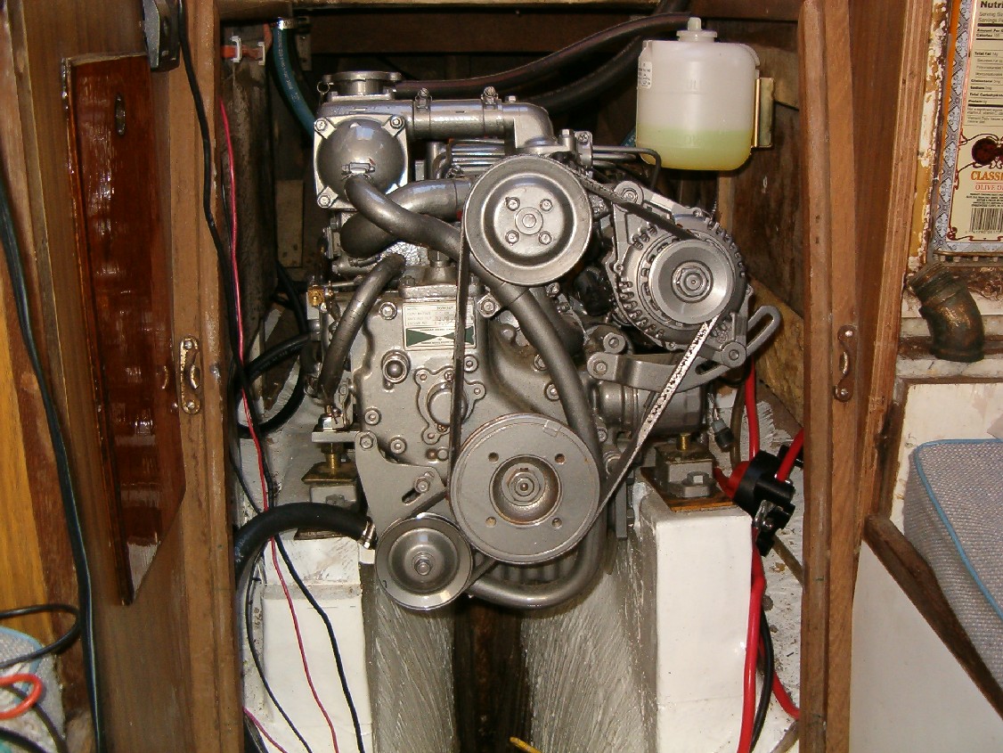

I am neither a certified mechanic nor the son of one. I did install my Yanmar 2GM20F. I also enjoy searching the web. Here are three pictures, for what they are worth:
From the web - http://www.alberg30.org/maintenance/...nmarphoto5.jpg
Here are two from my engine - I think mine were a bit high:
http://rikhall.com/Engine%20coolant%20tank1.jpg
http://rikhall.com/engine%20coolant%20tank%202.jpg

Rik, I'd not seen that Alberg engine photo before. That looks like a great setup, but my Vitus takes up too much room. I did notice that the middle of the tank is about the same level as where the hose comes out of the heat exchanger.
I'm heading down to the boat now to take another look. I may end up relocating it in a cockpit locker
