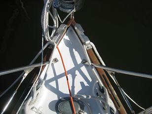

As for bow rollers, it really depends on how your foredeck is setup. A photo of it would help...as would saying what 31' sailboat you have.
I have a 1971 31' Seafarer Yawl - Bill Tripp design. The bow is shown below.
I have a Kingston model BR-20 anchor roller with a Delta 22# anchor. I am trying to determine the best way to attach the roller. I think the chain stopper is a good idea, but I'm not sure how to configure in the space provided.
Thanks for everyone's help.
Dan

Dan—
IMHO, you'd be better off running the bow lines across to the cleat on the opposite side, rather than to the one on the same side, as the line would lead far more fair and probably chafe less, since they'd be making a less sharp turn and wouldn't be rubbing against the pulpit stanchions.
You'd probably have to relocate the cleats and the chain pipe to accommodate the anchor roller and chain stopper—since your foredeck is almost as small as the one on my boat.
If you can put a bigger image of the foredeck up in your picasa account as well as say how big the bow chocks are in inches, I can see if I can draw something up that might work for you.

  #16
Old 12-15-2008
Join Date: Oct 2007
Location: Keymar, MD
Posts: 47
Danjcon is on a distinguished road
I think this is a larger image. The bow chocks are about 8 inches long. I was planning to replace them with smaller chocks to match the other ones - 6 inches long, and move them further aft, just ahead of the pulpit post. That would allow for a place to put the bow roller. I could add a cleat further back. Not sure what to do with the hause pipe, since that is directly above the space where the anchor rode is stowed.
  #17
Old 12-16-2008
Don't go down in size on the cleats. As it is, your cleats are a bit undersized IMHO. A 10" cleat can handle two 5/8" lines. An 8" cleat can only handle two 1/2" lines well. This is based on the rule of thumb that a cleat can handle two lines 1/16 its length in diameter, which is pretty accurate IMHO.
Looking at the photo of your foredeck, what I'd do if I had your boat is move the bow chocks aft along the toe rail so the forward end lines up just aft of the stanchions. Then I'd mount the bow roller over the starboard side toe rail, angled slightly to starboard, with a teak block supporting the aft end of the roller. I'd add a 4" mooring bitt to the deck in front of the chain pipe, to secure the chain to.
This leaves you the option of adding a vertical drum windlass aft of the chainpipe that could have the chain fall into the chainpipe.
