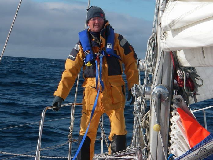

Originally Posted by catamount View Post
To the original question looking for pictures of separate tracks on the mast for a storm trysail, here's a pic that shows the setup on my father's former boat:
You can see the track on the starboard side of the mast starting at about the height of the top of the cowl vents running up past the coiled halyard, the gooseneck, winch and then alongside the main sail track.
Looking over these pictures, all I can say is thanks. (That and I'm reading Storm Tactics by the Pardeys, which talks a lot about tri-sails.) I didn't know you could add a separate track. I thought it was built into the mast form the get-go. Now I see it is an add-on, quite nice.
