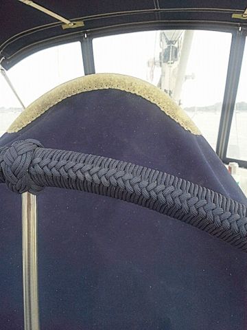

Originally Posted by Ritchard View Post
No kidding, great job. Can you show us the knotting techniques?
Ritchard -- Great job on the table!
The knotting technique for the wheel couldn't be simpler. As you can see from the photos, a series of slip knots creates the braided look. We pulled each knot as tightly as we could (a sailing glove is key) then pushed the wraps together as we went along. When we wrapped the wheel, placing the "braid" along the outside allowed us to put more wraps between each spoke. Later we turned the braid to the front where it is more comfortable for steering.
I played with lots of options, some that I found in books, some that I made up. The great plus with this version that I made up is the spool of cord never has to go around the wheel or be strung through anything. Note that the cord hangs in the same spot in both photos. I hung the spool from the pedestal so the cord would roll off the spool. When the spool was standing on end on the floor, the cord twisted as it came off the spool. The wrap looks much better when the cord doesn't twist.

Ho, ho, just what I've been looking for. No round and round and round.... And looks better to boot.
Thanks!

I hate to be a spoil sport, but is there any chance of crevice corrosion under that? I used to lock my wheel with a bungee loop in the slip, and found some signs of crevice corrosion under it after a week or so - and I am in a freshwater river.
I'm sure you're not the first person who has done this, so maybe someone else can chime in.
