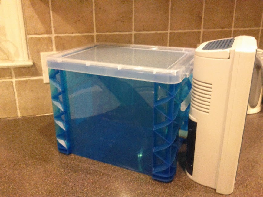

Dehumidifer with large reservoir
I bought one of those peltier dehumidifiers to keep the moisture at bay when I am away from the boat. I live in NC, so ... well .. it can get humid.
http://www.amazon.com/gp/product/B002BWSKTS?ie=UTF8&camp=213733&creative=393177&creativeASIN=B002BWSKTS&linkCode=shr&tag=eauciuen0a-20
This one has a removable tank and an auto shutoff when the tank is full. It holds a few cups of water ... less than a quart.
But I found that, in the summer, the unit could fill that little tank in less than a week. I decided to modify the thing with larger capacity but still retain the auto off feature.
I ordered 2 of these:
http://www.amazon.com/gp/product/B00BD6SXL8?ie=UTF8&camp=213733&creative=393177&creativeASIN=B00BD6SXL8&linkCode=shr&tag=eauciuen0a-20
A plastic storage box with lid ($10 at target)
A timer ($5 at target)
and a 4" piece of scrap 1/2 PVC.
It can easily run for weeks on end without filling up the tank, and the shut off feature is retained. The container has tight lid so the moisture removed does not return to the cabin. It significantly increases the amount of moisture the humidifier can remove. Now I can rest assured that the little humidifier is doing its job even when I am away from the boat for 2 or 3 weeks at a time (which sadly I am sometimes)
used a forstner bit to drill the hole, though its probably not the best choice for plastic. (it's what I had)
randyrhines likes this.

Impressive work, but why not just run a hose to a sink drain? Then it can pull out lots and lots of water.
I close all below waterline seacocks, including sink drains, when I leave the boat. That was my motivation behind increasing the capacity (guess I should have mentioned that important detail)
