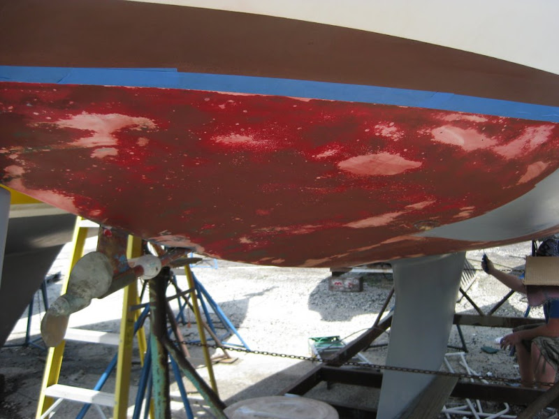

Bryan,
If I may suggest... please slow down!! You are actually wasting your time, $$$ and effort if you are not removing ALL the previous paint before applying a barrier coat.
Edited: Disregard above as I see you are already done and it's too late. Next time, which there will likely be, you really need to remove all traces of old paint and get her down to the bare white gelcoat. This takes lots of time and lots of effort. There's a reason yards charge 4-10k for bottom jobs..
Applying a barrier coat over any traces of bottom paint will leave you with areas of very poor adhesion compared to the areas over bare gelcoat. It's really kind of like building a house with only the sheet rock as you need a solid foundation for the sheet rock/barrier coat to be nailed to and with paint there you just don't have it .
The bottom MUST be down to bare gelcoat for a proper bond and a quality and lasting protection layer. Sorry to be the bearer of bad news but you actually had a lot more work to do before the application of a barrier coat..
It definitely should NOT look like this when you are applying a barrier coat:
It should look more like this with NO paint left:
