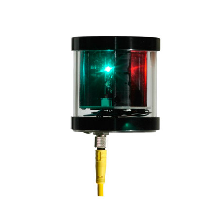

Bebi electronics, Bebi Electronics-Home of the Finest Marine LED Lighting Products on Sea (or Earth)!, makes LED lights specifically for marine applications. I have their lights in my tricolor, anchor light and steaming light. They work perfectly and are highly visible. They also have a great story to tell.
All the above lights draw considerably less than 1 amp, which means that when I re-wired the mast I used 16 ga wire, and I no longer get nervous leaving the lights one for extended periods.
The technology of their lights is much better than the LED / resistor method used by automotive LED lights. The Bebi lights use a regulator that greatly extends the life of the light, especially in the marine 12V system.
I heartily recommned that you visit their site, and no, I am not a paid spokeman.

Anchor lights, there is an interesting subject, especially in the US. I carry two sets of nav lights. Rhosyn Mor is British registered, but I have a full set of USCG approved bulbs for use in the USA, and a set of LED's for the rest of the world. THe LED's are much brighter, but not USCG approved. In case of an accident in the US you would want to be able to prove that your systems met all legal requirements, I am not sure that most LED's meet that requirement in the USA. The LED lights from BEBI are wonderful, anmd cheap.
I just took a quick look at this site and while the products look nice, I didn't see them mention that the fixtures are USCG approved. Did I miss that? If not, people need to consider the potential liability issues of using non-approved fixtures and bulbs for nav lighting.

Our lights have not yet been submitted for testing by any nation's government agencies as navigation running lights (port, starboard, stern, and tri-color) or anchor lights, so you must install them at your own risk (more details can be found here).
WELL THAT sounds pretty useless
