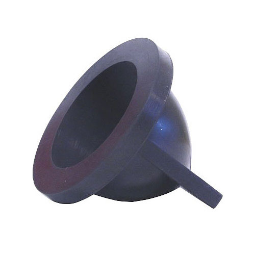

The check valve you speak of is actually called a joker/choker valve. It is in the drain line, just after the flush bowl. It is a diaphram style rubber tube, cone'ish in shape for lack of better description, that will allow fluids etc to go one way, but is supposed to NOT let things back into the bowl. Assuming you have a better brand head, you should be able to replace this rubber cone, and not have any issues as you describe, until the rubber hardens up etc again, then you replace it again!

Looks like this, located (like Marty said) in the discharge line right after the bowl.
