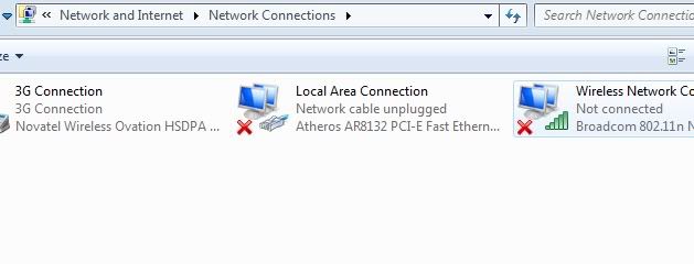

Can anyone help me to figure out what's wrong here. First off, everything arrived and it all went together just fine. The Bullet M2, a TP-Link TL-ANT2412DI Antenna and associated gear. I have followed the directions using both of the following sets of instructions.
http://www.ubnt.com/downloads/Nano_Quick_Set-up.pdf
Bullet setup.pdf - 4shared.com - document sharing - download
I have spent 2 days trying different things with no success.
This is my current LAN setup.
At this stage, I get two green lights on the Bullet. From here on in it gets tricky to get into the AirOS setup page. Sometimes I can get in if I disconnect the power wait a while and re-connect and eventually I get in. Once in, I have tried updating the firmware under the system tab many times. I was able to download v 5.3 firmware but during the upload it gives up and I can't get any further.
So I gave up on that and decided to set the network up under the network tab. So I re-power the bullet and start over and I go to the network tab. Here are my settings:
At this stage, the Bullet's two green light are on and I'm still connected. But once I push Change, the upper lights on the Bullet start flashing continuously/randomly and my LAN connection rotating messages between "network cable unplugged" "Identifying" "unidentified network". See image below. Nothing will happen in the AirOS setup page, ie: The "apply" button does not appear at the top of the page.
I've tried everything I can think of including re-setting the Bullet using the button on the bottom of the unit. I have also disabled the firewall. Right now I'm using Windows 7 but I have also tried installation on my other laptop running XP.
Any help would be appreciated.
Steve

READ THIS ARTICLE I WROTE If you still need help after reading it, PM me a phone number I can reach you at, and I'll see if I can walk you through it.

Thanks Dan, I'll let you know how I make out.
