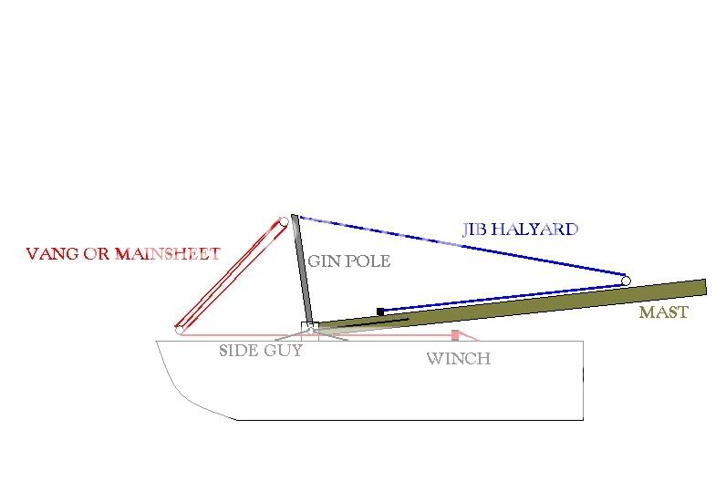

I'd love to see a pix or diagram of the onboard gin pole( using boom or spinnaker pole ? ) with jib halyard & vang assembly. A cable assembly came with the boat, fits the description of the side guys so shear shouldnt be an issue. Will I also need a second pole to help lift mast thru the first several feet of raising ? Thanx

OK, let's try a drawing first and see if you can make heads or tails from my poor artistry. The picture below shows all the gear lashed up as it is sitting with bottom of the mast loosely fastened to the tabernacle and the upper end resting in the mast crutch. With some experimentation you can rig it so your line lengths allow you to winch the mast up in one sweeping arc. It's a matter of matching the available length of your vang or mainsheet to your halyard. On mine, the vang is just barely long enough so I've made a permanent mark on my halyard where it needs to be cleated off at the mast. The shrouds and back stay are left connected while the mast is down, as well as the top of the fore stay. As you slowly winch the mast up keep a watchfully eye on the shrouds and stays so they don't tangle as you raise. When you reach vertical, connect your fore stay and you're done.
I've seen a lot of setups that use a post permanently mounted on the trailer that places a boat winch a few feet above the bow of the boat and utilizes the halyard an side guys only. From what I've seen, that works well too. I think the key to safely raising the mast in either case is the use of well designed side guys (ones that prevent the mast from toppling sideways throughout the arc). The one advantage I can see to my method is that it allows for lowering or raising while on the water if need be, although I've never done it.
If you can't figure out my chicken scratchings, let me know.
