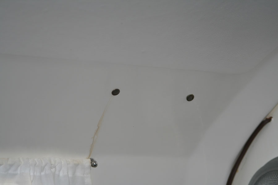

I can't see any plugs, the inner cabin seems to be fiberglass, I'm pretty sure it's quite close to a stock C&C Mark I, I may have some images online somewhere of the issue, from the inside it's just silver rivets. Either way, plugs seems like I'd have to drill out the handrail no?

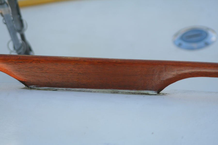

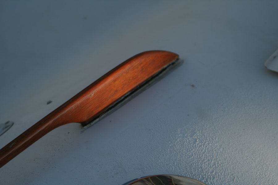

The hand rail is in good condition, seems a shame to waste it, and the other side to match. I haven't been able to indentify any plugs. I realize the risk of having this issue, fortunately I'm in Toronto, mostly just sailing Lake Ontario, here are some pics,

Those are just metal filler plugs, you can just pry them out of the head liner and you may see the head of a wood screw or else a nut from a through bolt. If it is just a screw head you may be able to tighten it from inside. If it is a bolt, to tighten it you will have teak plugs on the outside of the hand rail that will have to come out.
You can get white plastic filler plugs to put back in the liner to replace the corroded ones you have now.
Looks like it is wet between your liner and the deck, you may want to give it some attention. Typically your sealant under the handles will not be in such good condition any more. Then of course you should also consider potting the deck holes.
Owning an old boat is so much fun.

Thanks, knowing that those are just covers gives me a good place to start. I'm sure there's some moisture unfortunately. Great info.
Old 02-26-2010
It does look like you have a fiberglass overhead liner, and the screws are under the metal caps.
