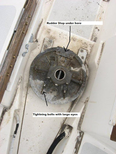

I am about to help a friend replace the wire on her Edson Steering system on a Hunter 30. As per Edson's recommendation I'm sure all of you change the steering wire every 4 years, so your advice would be appreciated;
As per Edson design policy all the stainless bolts have fused with the aluminum so I see lots of drilling in my future. I would like to just remove the rudderstop and try and remove the cables from there. My main question is, can the tightening bolts be removed this way as they appear to be quite long and can they be removed up through the steering pedestal without having to unbolt the pedestal. There is no way that the Radial drive wheel can be removed from the rudder shaft without resorting to explosives.

Just one more reason I am glad to have a tiller-steered boat. Have you tried using PBblaster on the bolts?
Also curious, why explosives are not an option.
Do you have close up photos of the area in question???

I have done a regular close-up inspection of our cable steering system. It's a YS system from '88. Wires are holding up OK, but several years ago I did have to remove and rebush the sheaves that turn the wires 90 degrees from the base of the binnacle. If those particular wires ever did jump out of the sheave they would likely jam, and your "emergency tiller" would avail you not... until you used large cutters on the cables to free up the system.
