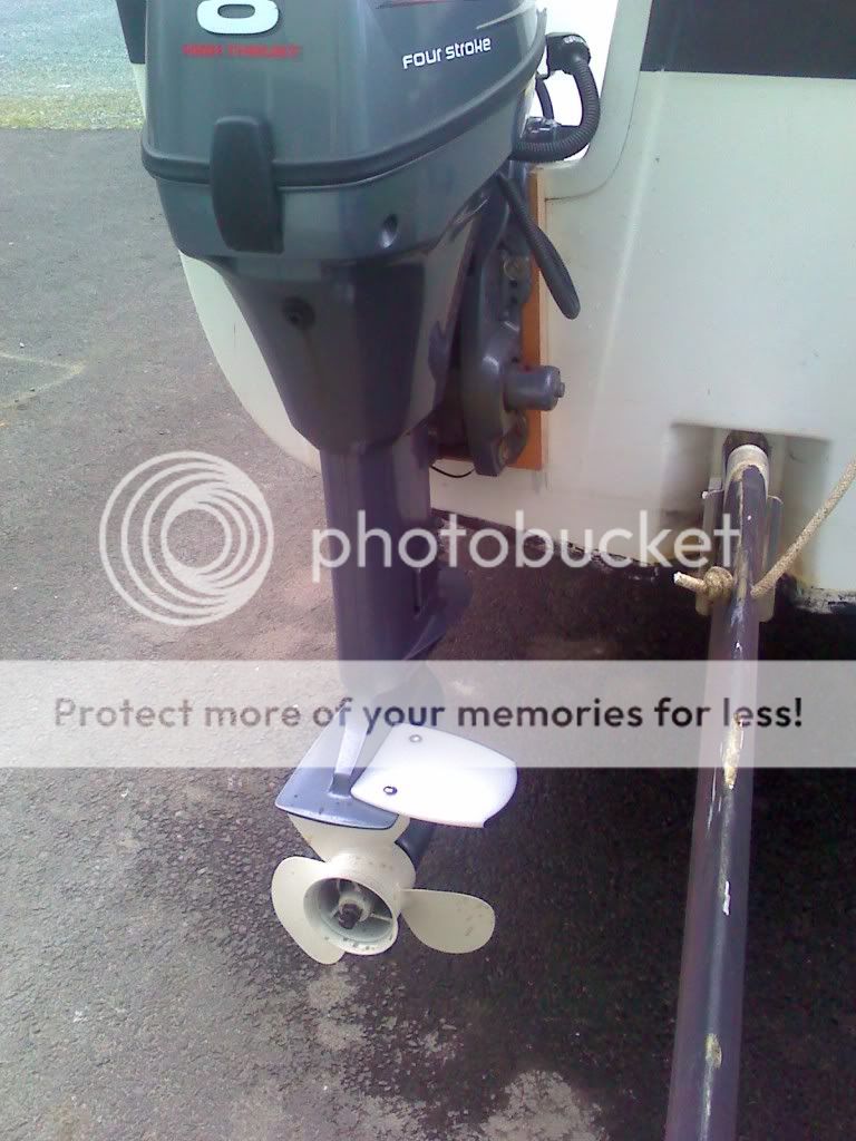

I have no experience with your particular boat, but I would at least try for a mounting option that allows you to steer with the outboard. I leave mine in a fixed position about 99% of the time and steer with the rudder only. But that 1% of the time that I need the outboard for steerage in tight spots ...... well, lets just say the extra maneuverability is priceless. It will also allow you to motor in even if your rudder becomes disabled. Be especially careful with your prop to rudder clearances however. Angles may be such that the rudder will not hit the prop when the outboard is in the fixed position, but may when the motor is turned. You might need to add a simple prop guard to your motor to keep that from happening.
You can see the simple guard I made and mounted on my outboard to keep the rudder from coming into contact with the prop. You can also see the damage the prop did to the rudder before I dummied up.

Prop guard is a neat idea. However the Catalina 27 layout is pretty different.
There's a hole in the transom and the motor is mounted on the lower edge of the hole. The rudder is a spade type that projects out a bit aft of the transom, but not as much as the rudder in that photo. I wouldn't worry about the rudder hitting the prop.
In fact, I briefly used a 6 hp Tohatsu while the starter and stator disc on the Evinrude were being replaced, and that had a tiller and you could turn the motor. However, because the motor is mounted in a hole, the angle through which the motor can be turned is very restricted; maybe 20 degrees off centerline if I recall. Mostly I used it to support the turn I was creating with the rudder, but that was a lot of hassle and I eventually gave up on it.
A big source of discomfort there---and it will not go away if you change the way the motor is mounted---is the way the motor is mounted. The motor is accessed through a hatch in the cockpit that leads to essentially an aft lazarette, whose after wall is the transom where the motor is mounted. You'd have to be reaching in there to manipulate the motor. On that note, where are your mainsheet and traveler? Mine are end-boom, which can get in the way if I need to get into the motor well.
If you were to mount the motor on a lift bracket, I don't see it getting any easier to vector the motor. The motor's tiller will probably have to be left in the vertical position anyhow, but a lot depends on your lift bracket. Plus it's so far aft, and you have the stern rail and that lazarette to contend with, along with possibly your mainsheet. That's a lot of stuff between you and the motor.
In the end, I would not count on steering with the motor in an early-period Catalina 27. As you say you are a little new to sailing, your best strategy is not to get into situations where your rudder can be disabled anyway. If your boat has tiller steering there's very little that can go wrong other than striking something big and heavy and dense in the water. Don't do that.
