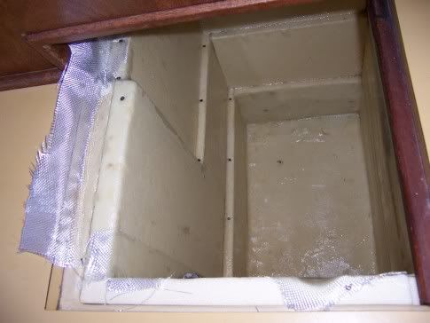

Home Depot foam
This is a boat like ours. This person has tore out the old box and created a new one. We would not want to do this. It does show that he used Home Depot foam.
"This pic shows the old fiberglass box lined with layers of closed cell, foil covered foam sheets (Home Depot). There are 7 inches on the bottom and 4 inches on each side, with spray- in foam in the irregular cavity on port side. The ply panel on far right is to provide a suitable mounting surface for evaporator screws. Next step was to cut a 3/4” ply cover for box, fitting it flush with the original box lip."

The refer
I went to Lowes yesterday and looked at the yellow insulation in sheets. I think it was a R-5. They were I think ¾ sheets.
So we know how to do it just not the best foam. I am guessing I will go with the yellow sheets.
This is a boat just like ours. This is the refer. Next to it is the freezer. It is an overflow system. About 7 cft.
This does not show the freezer part.
First it was coated with fiberglass I think. I have not found the “how we did it” yet.
You can see how he filled the first section of the bottom.
Then they added foam.
Then fibreglasses it.
The bottom is way too deep and it can be filled up about 4 to 6 inches.
The outside of the box has little room for adding insulation.
Some sides can get 3 inches.
Some because of entry limitations can only get 2 inches I think.
He preserved the shelving platforms.
Again this looks like the white Home Depot stuff.
I am still looking for his how he did it text.
