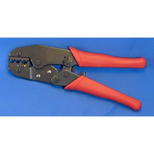

You should use adhesive-lined heat shrink covered terminal, like those available from FTZ or Krimpa-Seal. Crimp them with a ratcheting single crimp tool, like this one, available at Fastenal.
Krimpa-seal 320 piece kit is available from Fastenal as well.
That is a really nice tool, but for ~$25 instead of $90 something like this might make more sense for many of us.

That is a good type of double crimper for non-heatshrink terminals. It will however damage the heat shrink a lot of the time if using terminals with heat shrink. For these you want a single crimp tool like dog showed. There is probably a more affordable single crimp tool available as well for occasional use.
As far as books, "This Old Boat", the newest edition and Nigel Calder's "Boatowner's Mechanical and Electrical Manual" are the only 2 you might need.
Brian
Old 07-11-2010
One advantage the tool I pointed out has is that it can do 8 AWG wire, which a lot of the others can not. It is also available for far less at other retailers...and when it is on sale at Fastenal. I bought one on my recent delivery, since the captain didn't have one aboard, and they were on sale for about $60. I'd point out that buying cheap tools is generally a mistake.... you generally pay for them twice—once when you buy them, and then once when you buy what you should have bought in the first place....
