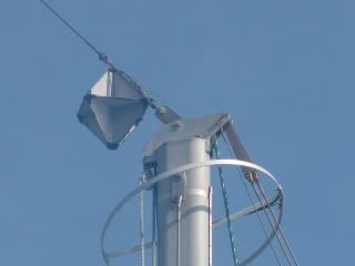

I value the UK Radar Reflector evaluation and yet I will remain presenting my radar image with my simple three planes of aluminum with my "Plastimo" style reflector.
Here, my reflector is mounted on my triatic just forward of my mizzen at about 38' above the water. I commonly see these same reflectors easily visible on my radar when they are mounted on commercial fishing equipment at 4' to 6' above the water. I will not attempt to dispute that other reflectors may have a better test result, but it might be suitable to use a reflector such as mine and ask other boaters to give you feedback about your image on their radar units. I do a lot of New England summer cruising and I'm consistantly well seen on radar screens. Take care and joy, Aythya crew
