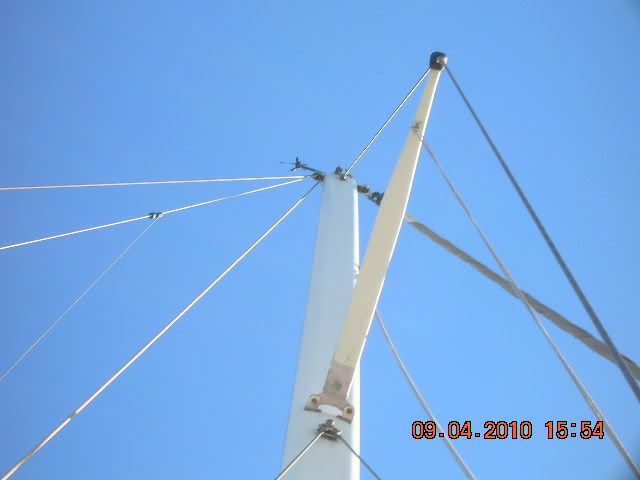

We looked atop the mast this weekend and saw what looks like a wind vane. It is not moving. So I guess that’s that.

The unit extending aft from the top of the mast is the wind sensor. The piece with the three cups is the wind speed and there should be (can't see from your photo) a vane on top of that for the wind direction. Without a manual and wiring diagram, its going to be very difficult to troubleshoot. Could be the wind direction vane is missing, bad direction sensor, problems in the cable from top of mast to display, bad display, etc.
