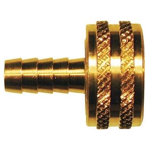

Old 12-13-2010
How about this:
Get one of these:
and one of these:
and one of these
Click the photos to get the webpage for each item. This allows you to cut the line and install a ballvalve. While they're not "marine" grade hardware, this is your freshwater tank system, so marine grade isn't totally necessary.
BTW, you can probably get the various parts in "marine" grade, but I don't see a need for it.
