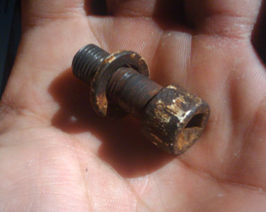

I found this bolt under the engine, and it looks to go into the end of the coupling on the end. It fits well, but doesnt thread easily into the hole. I put it in once, and tightened it a bit, but not all the way because there was some resistance to threading/screwing. It has fallen out again and im wondering if anyone has a good solution and knows what this bolt does. Any help is appreciated
Im fairly new to engines
thanks
austin

Austin,
I don't think that screw goes into the engine at that location. I would look for other locations the missing screw will fit. It could also be a miscellaneous screw that fell into the bilge.
The hole in the coupler is probably used to mount the material into a lathe to make the part and is no longer functional.
Nick

Im pretty sure of it.
thanks for the reply
Im pretty sure its for that hole, for the following reasons
1: The chipped and faded white paint is on both the bolt and the coupling parts, but nothing else
2: Inside the hole there are clean threads that seem to match the bolt depth
3: It fits... Im just not sure if I should tighten it down all the way (against the resistance) or what, and how/why it has worked itself loose.

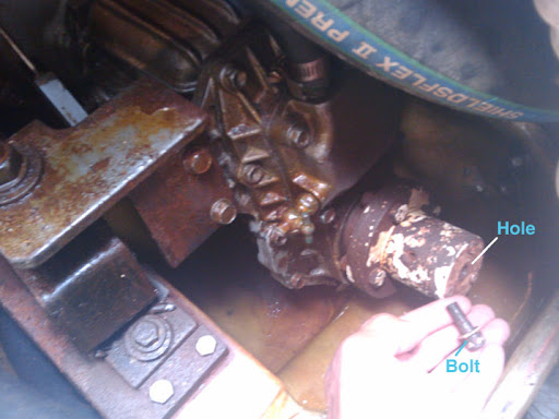

You likely have a double taper shaft and that bolt is holding the shaft into the coupling...
This is a double taper shaft for a non-v-drive. A v-drive would have the taper going the opposite direction as yours is.

If thats the case
Ok and that bolt i can see in the image at the center of the shaft is probably the one that im talking about?
If so yikes, Ill place it back in and see if I can at least tighten it back to where it looks like it was.
Are there any problems, suggestions or things I need to watch out for with this bolt?
thanks all
