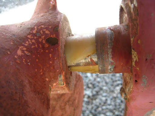

Turns out my prop had a reducer on it made of some sort of plastic. It had broken at some time and caused the prop to be loose on the shaft, with a lot of associated vibration when running. Just a heads up that they might fail eventually. If you sense a ton of new vibration in the engine make sure to check the reducer to see if it stripped:

Not sure honestly. I was wondering how I should replace this and figured there must be a more sturdy solution than the plastic one.
