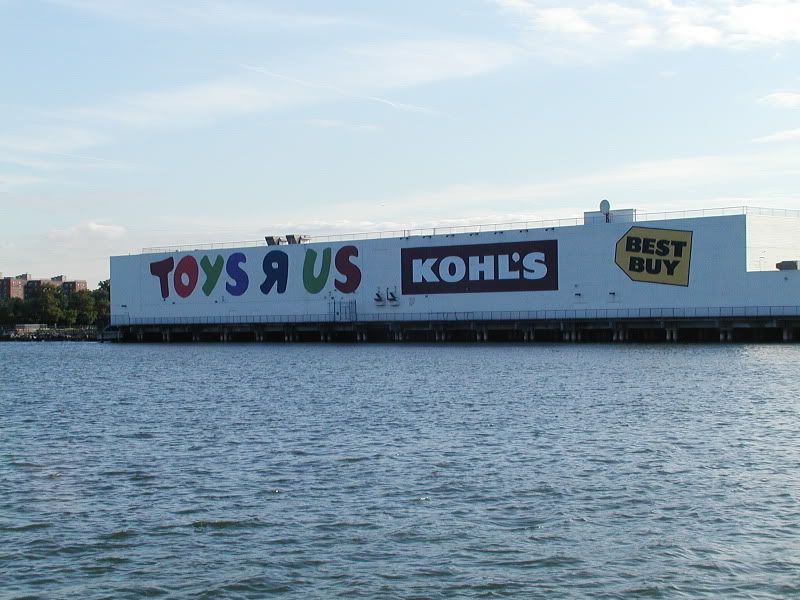

All i can say is on Long Island we have anchored everywere from the Toys are US in Brookyln during a 50 knot storm to places all over the east end and north shore in 24' to 35' boats and never had a problem holding with and old school sand anchor
