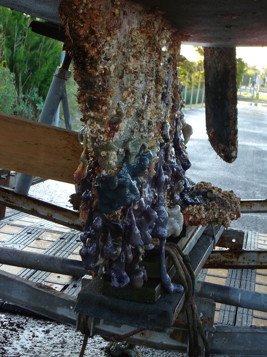

Every marina should have a sergeant at arms who is to shoot the owner on sight, if their keel looks like that.

looks like a character out of 'Pirates of the Carribean!!'
in fresh water the carp can help out some by sucking off the yuck.
