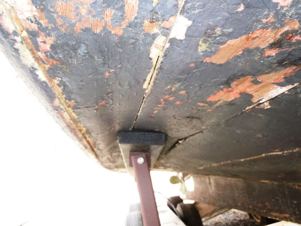

Here is a real challenge. Winaway, a 1924 Schertzer Raised Deck Cruiser in seriously bad condition.
She has issues with sitting on a trailer for far too long which has caused some hogging to Starboard.
and

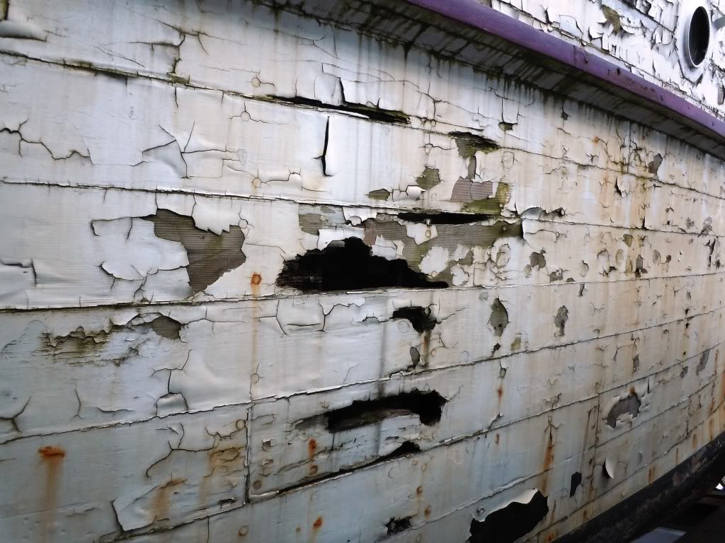

She also needs about 25 planks replaced.
and
The upper section and wheelhouse are in decent shape.
with the exception of the back wall port side.

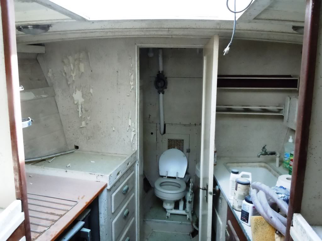

The interior isn't too bad.
and the deck is mostly ok.
and
Some of the planking to starboard has plywood screwed over it which leads me to believe we'll be replacing the planking there. The initial plan is to build some framework to attach to the starboard hull so we don't have to put stands under that starboard side. We'll use templates made from the port hull frames (which are not hogged out) to replace the starboard framing. I'm hoping I don't have to pull the house and roll her over to do this.

Well, the car looks good!! what are all those random hoses in the galley?
