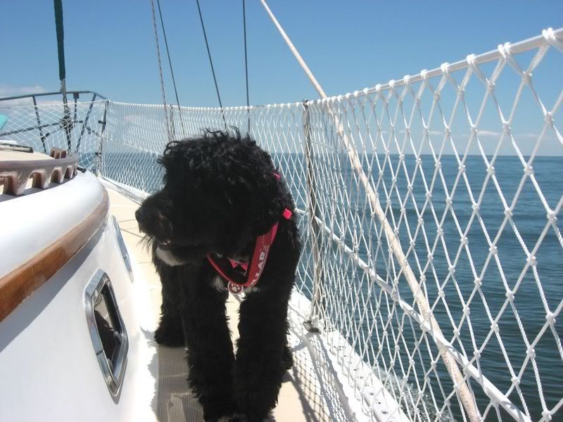

We have a small PWD and she likes to roam the deck no matter what the heel angle is. So, in order to keep her out of the drink we installed lifeline safety netting. The lifelines support the netting up top and a line between the stanchion bases secures it at the bottom. At the gates, I simply secured the netting with a plastic tie right where the pelican hook screws on the lifeline to keep the netting from sliding when we open the gates. At the bottom, at one end I tied the line to the snap hook which I attach to the bottom of the stern railing. When the on the way, I also use couple of very short sailties to keep the netting close to the stern rails.
With this setup it takes seconds to open and close the gates for boarding and the netting stays in place.
The pictures below are cropped shots, hence the detail is not the best. If you would like, I could take a better picture this weekend and pm you.

I have attached a line to an old, clamp-on style fairlead (minus the sheave) with a snap-hook. This way it is easy to open lifelines for boarding and the line stays fairly taut. Not sure if this would work for a very small dog who is bent on finding an escape.

Thank you for the pictures. I now know what you mean and it gives me an idea on what I can do.
