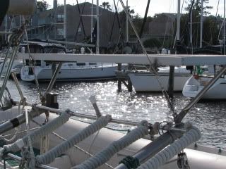

I have one line led from the top of two double sheeved blocks with snap shackles cliped to lift points on the dinghy.
Ignore the presence of the boarding ladder laying across the davits. From the end of the port davit you can see the upper of the two blocks. Ihave no problem manually lifting my Caribe RIB with this set-up on my MorganOI, although, I do raise the bow and stern of my dinghy with alternate pulls. Take care and joy, Aythya crew
